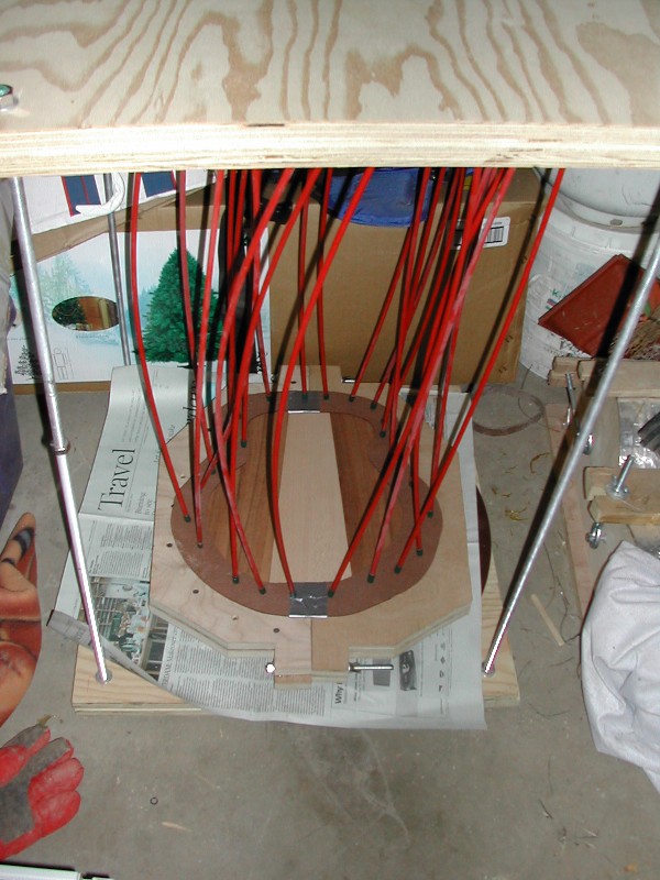

You don't really need any plans. Just take 4 pieces of 2' x 2' 3/4" ply and place 2 of them on the bottom and 2 on the top. Drill some 5/8" holes in the corners and get some 5/8" all thread with washers, and bolts for top and bottom. Should take you about an hour to screw it all together. My all thread is about 3 ft tall.

I will give this bit of advice, laminate togather 2 3/4" ply or MDF sheets to make your top deck the rods put a good amount of force on the top deck and deflection could allow a rod to come shooting off the clamped object. most written plans I have seen ave called for a 3/4" ply or MDF top and bottom deck. This is not stiff enough.

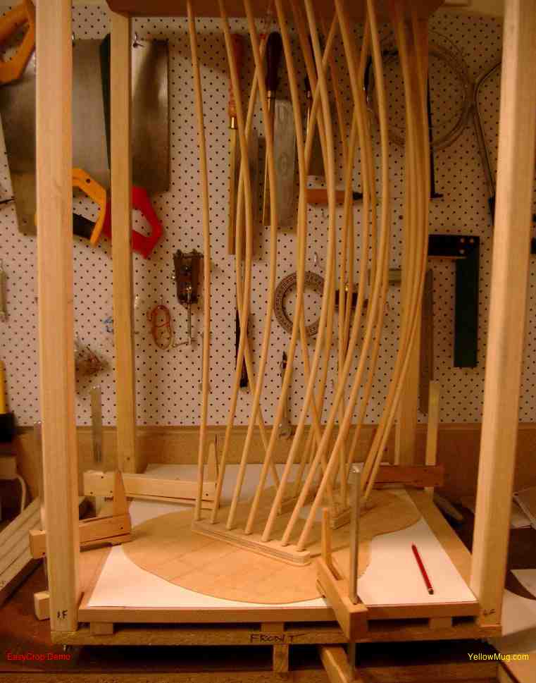

My gobar deck...bottom deck has an adjustable floor to cater for varying heights of work being glued up.

Max, if you go with the all thread, don't forget to use something to cover the threads, like PVC or conduit.
